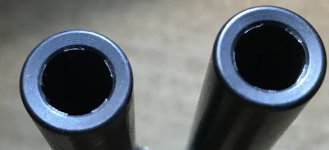

Cleaned the new barrel after my trip to the range and noticed two things:
Original 4.0" barrel has concentric circles on the crown vs a flat face on the 4.2"
The number 29 or 62 is stamped on the 4.2". I assume it means nothing.
Those concentric circles on the muzzle are just where the lathe tool was starting to dull (probably a very small chip in the tool) when the barrel was faced to length.
There are several ways to induce tool chatter in the barrel manufacture process. Some makers have lots with more chatter than others.
The numbers mentioned make sense to the barrel maker. They might be heat treat lots, material lots or something other.
