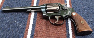

I have a very nice M&P from the early to mid-thirties (6275xx) that is not a reblue that has a plum-colored cylinder. I find it both interesting and attractive. I have a K-22 Outdoorsman that's just a bit newer (6574xx) with a cylinder without a trace of the plum color. But . . . my S-prefix transitional M&P (S 9528xx) appears plum-colored in bright sunlight.
FWIW, my Ruger No. 1S receiver made in 1984 is plum-colored, while the receiver on my No. 1V made in 2000 has nary a trace.
The photo is of my early M&P.
Addition: On a rifle I built on a Mexican Mauser action back in 1959, my gunsmith deliberately made the bolt shroud plum-colored by "bluing" it in salts at a higher temperature than normally used to truly blue the metal. (For the sake of others here as old as I am who lived in the Chicago area, I'm referring to Paul Haberly at the Chicago Gun Center.)
Interesting that the ejector rod is also plum colored.
