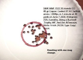

People say the M&P 15-22 isn't as accurate as say a CZ bolt. Having never owned shot a CZ Bolt, I couldn't say but my 15-22 shoots anything I put in it but prefers CCI AR Tactical Copper Coated solids. This was just after I bought it 5 years ago. I took the Bushnell Red/green dot off and put the handle site back on. It's still accurate enough for 30 yd head shots on tree rats. I have several other .22's but I tend to take the M&P15-22 over the Ruger's and Henry. Though my is probably
a touch more accurate.
