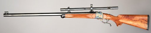

Had to crown my 458 No.1H after two local smiths
could not get it done, after I cut it down.
Long sad story.
Had cut it to 16.5" and got it close with files.
The steel rod with detailing tape, wrapped almost
all the way around in four places, offset the spaces,
fit in perfectly as a pilot.
Glued each diamond stone on and turned it by hand
until it was right.
Fine 45 degree round stone dressed the bore at
the muzzle.
The sight was a chore, but it shoots great and swings nice.
Goal was to have a 34" barrel installed, but back in the early
'80s, none of the nation's top Smiths, could get a high quality
barrel that would finish at 34", just 30".
Navy Arms had one but not of high quality.
Doable now but I might keep it like this and the plan was always
to make white stocks, long forearm, carved and name it the
Snow Dragon.
