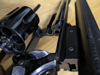

FActory Remington ammo is reputed to erode forcing cones very rapidly. I shot a couple boxes of it before I learned that, and realized the crazy price it brought. The PPU stuff is much milder. A photo of my forcing cone. I have since sold this.PXL_20240606_232527607.jpg
Thanks for the reply. That's what I remembered someone stating in the past. I came across some recently but questioned the viability of purchasing.

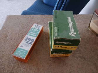

I won this the other day..
I couldn't resist at that price
$93 out the door incl shipping
I think you're fine but for the small savings over a known ammo dealer I probably would have passed. Just a heads up, SG Ammo has the same PPU for $35 per box with free shipping over $200. I get real nervous buying small batches of ammo online even from established sellers. I've been hosed twice with supposed "factory ammo" only to find a mix of headstamps, different looking primers, even got a blend of nickel and brass case once I opened the boxes. All the sellers swear it was a mistake or I was the one trying to pull a fast one.

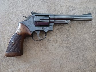

My Jet came with a 22 LR cyl and an additional 22 Mag cyl. ...Pretty certain the mag was added by the wholesale guy. Surprisingly that gun was most avvurate with the mag cyl....To be honest the Jet had a few problems...Squeaky clean brass and cylinders...Somewhere around here I have a couple boxes of ammo and some Rem and Hornady bullets
Does your reference, "22 Mag cyl." mean the 22 Rimfire Mag cyl. or the 22 Rem Jet cylinder? The 22 RF Mag(mod 48) cylinder is 1.62" long, which is too short for the mod 53 frame which requires a cylinder length of 1.67". The 22 Rem Jet cylinder was the standard cylinder in the mod 53, the 22LR cylinder was the add on from the factory.
