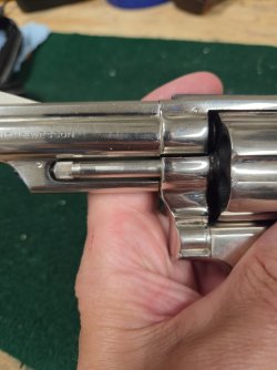

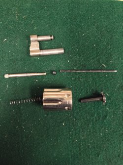

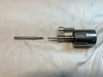

Ejector rod is tight & straight. I have cleaned everything for the 3rd time and it is still not closing correctly. Steelslaver said something about a gas ring. Looked on a parts drawing and see what it is but I do not seem to have one on my revolver. I have all that parts that are in Vtjw938's second picture (see my first picture). I think I know what he means by lug tooth, the spring loaded part that holds the ejector rod when closed. The cylinder starts to resist before it gets that far (see second and third pictures). Still at a loss.

In the first picture of your last post the ejector spring looks a bit wonky in the part nearest the cylinder…not sure if that’s just the camera angle or not.

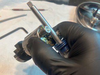

I took my 19-2 apart to get some measurements just so we can verify that nothing has gotten bigger. I know the individual pieces won't grow....I'm talking about "assemblies" that no longer fit together properly and therefore increase in overall assembled length.
The extractor by itself measures 1.612", the assembled extractor/gas ring/ejector rod assembly measures 3.909".
When you assemble the extractor/gas ring/ejector rod, does it go together without any gaps?

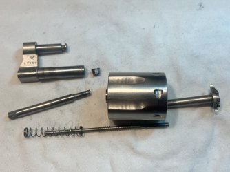

And what happens when you GENTLY put that assembly into the yoke and then into the frame? Don't force anything please. On my gun, the assembly snapped into place very easily and would rotate with just a slight amount of drag from the spring pressure of the front locking lug. In the picture below the yoke isn't quite closed because I didn't want to have to use a screwdriver tip to release the front locking lug a second time. :rolleyes:
