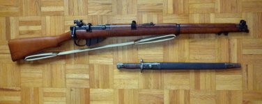

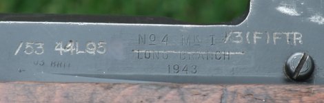

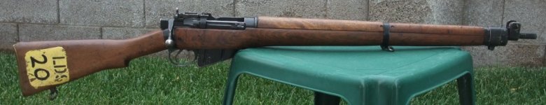

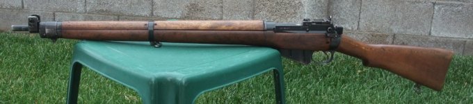

My Longbranch updated to Mk2 standard.

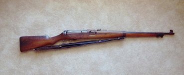

I only have three in .303. First is a MLE Mk I*. It was first issued to Canada who transfered 10,000 of them to New Zealand in 1914. I got some 215 gr RN bullets from Woodleigh (not cheap) for it.
Second is a Mk III*, which didn't have a good barrel. I got a new barrel, even had the original wax on the threads, and had Brian Dick, the SMLE guru, rebarrel it. As you can see, it also wears a Parrker Hale aperture sight.
The third is a Ross Mk II, which Canada transfered to the US when we entered WW I and were short of rifles. I think they were only used for drill. Its bore is not perfect.
I regret to say that none of them are particularly accurate. I've played with various loads and bullets with no better results. It must run in the family; my father, who trained on the Springfield, carred an SMLE Mk III* in combat in WW I. His diary notes, at one point;"Went to the rifle range today. Shot a pretty good score considering I was shooting a Lee Enfield".
