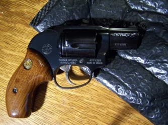

I will not own a DA only revolver for obvious reasons. I do understand the hammer spur snagging clothes argument. The above type with the shrouded hammer is a sensible way to have SA/DA in a concealed revolver. I own a Taurus Clone in .357. For personal C.C. I prefer my Russian Makarov, or smaller Polish P-64 (both tweaked) - Over the Heavier Chunky Revolvers. I would not carry a semi-auto pistol that was not 100% reliable, & am confident with my choices.

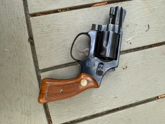

I wanted to try a bobbed hammer on my Model 36 for ease of draw but I was not willing to give up the single action capability. I found a used hammer in good condition, bobbed the hammer and filed grooves along the top of the hammer with a diamond file.
I am able to cock the hammer by using the old technique of pulling the trigger slightly and then hooking my thumb over the top of the hammer. Skeeter Skelton described this technique. You can decock in the normal manner.
This technique is not for everyone, obviously. Keep the muzzle pointed in a safe direction. I would never attempt this maneuver in an emergency or in a hurry. It allows you to make a precision shot when you have the time. I understand if some members would never consider doing this and hope that this thread won't veer off on that track too far.
I replicated the case coloring with the "WD-40 method." Apply a thin wash of cold blue then heat the hammer with a heat gun and, when it is good and hot, spray WD-40 on the hammer.
