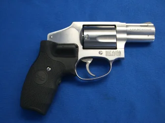

An as-new M65-3 acquired; preserved the original hammer; sourced a new replacement which was the subject of bobbing and conversion to DAO.

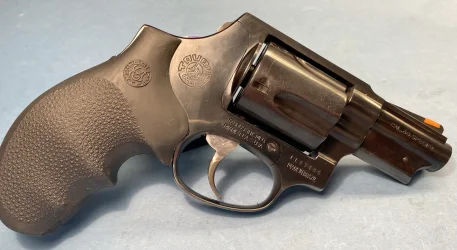

A new Taurus M85, bobbed hammer and DAO conversion as well; work horse for range practice to minimize wear and tear on nicer J frames.

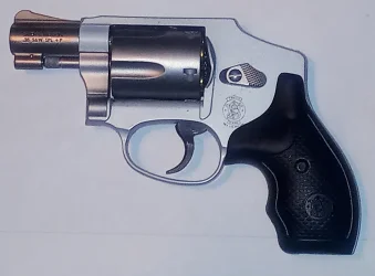

A M49 no-dash, trans -hybrid.
