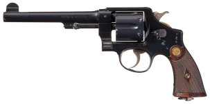

2nd Model
first photo 44 Hand Ejector
second photo 455 british and canadian service
third photo 1917 Army Model cal 45 Auto

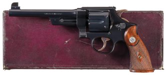

3rd Model "Wolf & Klar" .44 Hand Ejector
4th photo Wolf & Klar
5ft photo 44 HE target

I just posted the 3 variations to show the differences. Namely the 2nd and 3rd do not have the 3rd middle lock. The ejector housing disappeared in 2nd model and thanks to distributor Wolf & Klar brought back in 3rd. (From what I’ve read) although I do have a 3rd model Target that did not ship to W&K that has the ejector housing. Not an expert so maybe someone can add some texture.
finding a 2nd model in 4” or a Target sight version has eluded me.
