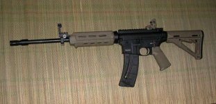

That's what a 15-22 looks like using a Tacticool22 barrel nut adapter with an AR15 Barrel Nut/Delta Ring, Carbine Length hand guards and an A2 front sight post. This is not all "bolt on" the sigh post requires some spacers to be machined and a way to affix the post.
Brett!
Thanks for the pics.. I have watched some of your YT stuff and its been great so far thanks!!
Here is a pic with the MOE stock, grip, handguard and BUIS in FDE. With a shroud and with just a flash hider. You can do anything you want to with these rifles. So ALL aftermarket and S&W replacement handguards are available for the 15-22.

Here's mine with one of Tacticool22's free float adapters used to attach a delta ring. I just used a quad rail gas block on mine. The handguard end cap had a lot of play which let the handguard move around, but I put a 10/32x1/2" SHCS through the gas tube hole and it doesn't move at all, now.
I am just waiting for some MOE rail sections I ordered so I can remount my MBUS on the MOE handguard. It's also going to get a Magpul ACS stock so it matches the AR I'm building.
