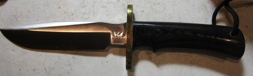

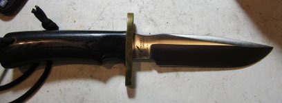

I collect (a few anyway) Black Jack knives. IMHO they are equal to Randall knives but never received the following, or commanded the high price tag. But Randall is still in business and the original Black Jack is not.
Hollow ground knives tend to have less metal behind the edge due to the profile, whereas convex grinds have more metal behind the edge - think apple seed shape.
