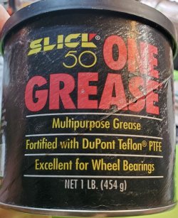

Recently I was watching a YT video on lubricating a firearm with grease. I have never used a "grease" on any of my guns. I live in the Arizona desert where the average yearly temperature is 73.7d F, and the average July temperature is 106d F. I decided to try some grease. I took some synthetic Slick 50 wheel bearing grease, with Teflon, and put it in a 5.0 ml syringe. I field stripped and, with a q-tip, put a very thin layer on key metal-on-metal shiny areas, slide rails and guide rod spring assembly, on my freshly cleaned and lubed BG2 and P365 Micro.
I was very surprised at the smoothness of the "feel" when racking the slide, but also surprised at how the grease reduced the actual sound of racking the slide. I "greased" 3 other pistols.

The 1 lb. can of Slick 50 One Grease has been in my garage for about 20 years. Rather than pay $10 or $20 for 1 ozs. of real "gun grease", I decided to try what I have. If I were to buy a gun grease I'd pick Clenzoil Synthetic Grease https://a.co/d/gqoS21F
