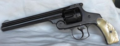

I cold blued a single shot .22 bold like the one I grew up with. It turned out more grey than blue but made for a more presentable and serviceable finish than the pitted rust it had. The stock butt was cracked so I sawed it off and reshaped the butt pad. It left it appropriately sized for their age. I sanded the stock and used Brewax on it. My boys learned to shoot with it. One bullet and manually cocked for each shot. I know I killed a lot of rabbits with the one I had. Theykilled a ot of cans with theirs. It was definately not a restoration but good enough for out purposes.
Nice old pistol. Are you sure his girlfriend's name wasn't "Savage"? ;)
I have not refinished any per SE, but I did salvage one from a grisly fate. Bubba saw fit to 'enhance' the pistol with his girlfriend's name electro-penned into the metal of the upper. It was screwed up bad. After polishing out the 'art work', the last phase was a homegrown cold blue. I hit it 2 or 3 times and Burnished & buffed it out to nearly the same appearance of the rest of the gun. I don't think you can identify the repair now.
