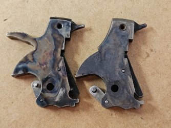

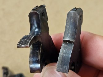

I purchased a NOS S&W factory-bobbed hammer for my m10 stubby. While the stock hammer has beautiful case hardening that looks oily-black, the bobbed one is very dull and ugly.
What would be the best way to make this look dark and shiny, similar to the original? All I've done so far is rub it with a clean cloth. Ive thought about oiling it but wanted to ask first.
Thanks!
Not much you can do short of sending it off to be redone or finding a brighter one.
The color is a very thin layer. Once its faded, all you can do is try to highlight what's still there with a clearcoat. Oil will highlight it but wipes, dries, or runs off.
With no guarantee of complete success implied, I would try wiping it down first with water and if nothing popped wipe with a little oil and then take a picture of it with the oil on and any highlights revealed - such as are already present in your picture of the right side.
Then I would clean it well and, having reference to the photo, apply oxpho blue, or your preferred equivalent, on a rather well pointed Q-tip and attempt to darken that which appeared darker. I would continue until reasonable satisfaction, wipe it down with some oil and declare victory.
Very little to lose and perhaps some color to gain. Please advise when/if you find something that works for you.
