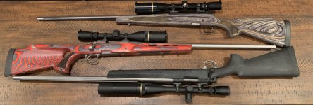

I bought a new Hogue Overmolded stock for a rifle many years ago. For those not familiar with them, they are a fiberglass shell overmolded with rubber; some have an aluminum bedding block running from the rear action screw hole to just shy of the forend tip. It was sticky to the touch so I contacted Hogue where I was told to rub it with WD40. I didn't hold much faith in an oily substance doing much good but one treatment and 20-odd years later, it is still sticky-free.
The photo is of my three Ackley Improved rifles; obviously, the one on the bottom has the Overmolded stock.
Ed
