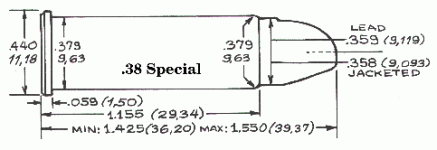

Okay, there are several things possible here.
#1: The revolver was originally chambered for the short and bigger 38 S&W CTG and has been since changed to be a 38SPL.
#2: The revolver is still chambered in 38 S&W and those bullet heads will work well enough.
#3: The revolver is a 38SPL. (Which I highly doubt)
Take some measurements of the case you are fitting in your cylinder. If the longer 38Spl fits, then make sure you stay on the low side of any data when you load for it.
If the 38SPL case does not fit in it, it is a 38 S&W and you can load that as much as you want, because there isn't enough case there to hold enough powder to do any real damage, in my opinion.
Hope this helps! Let us know!
