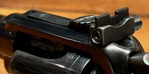

Froggie, thanks for your detailed response. I'll head down later today and take some additional detailed photos (I already submitted some of the cylinder, but will upload some additional photos of your areas of interest). The rear sight is very well made. I believe that someone has attempted to replace the original sight blade with a S&W target blade and screw. It works....sort of, but is different that the other examples I've seen on the forum. I'd love to figure that one out and bring it back to normal.
The revolver has no markings to designate who did the conversion, but I've heard Parker Hale (usually marked) and Cogswell Harrision (unmarked) did a lot of conversions, so I'm leaning away from PH.

I’m not an expert on markings of these, but agree that a Parker Hale barrel would be likely to be marked, but I haven’t seen enough confirmed C&H examples to comment on them. These two were not the only companies doing these conversions, since there were still numerous small gunmakers in London and Birmingham at that time as well as many small gunsmith shops who also would have been capable of this kind of work. The proof marks on the barrel might tell us something.
