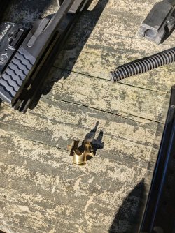

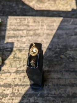

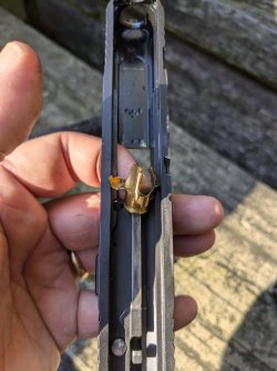

MP 2.0 Compact 9mm - hinged trigger version, no after market internal parts (milled for dot and sights replaced). Slide lock replaced with a new one from current production with the extended slide lock lever (lefty friendly). About 7K rounds on this RSA and 8K on the striker assembly. 23K total on the pistol.
IDPA match, shot to slide lock and inserted a fresh mag. Slide auto forwarded (not uncommon for this pistol) and the forward tip of the center rectangular rail in the middle of the slide hit the primer. My finger was not on the trigger. RSO confirmed finger was off the trigger and on the frame. Round discharged before fully entering the chamber. Bullet did go through the barrel and downrange. Round impacted in the side berm of the range just under the target.
SW has had the pistol since Nov 17 for inspection/repair. I'm getting very frustrated with them. If it is going to take this much time, just replace the slide under warranty and then spend however long they want on inspections. We'll see if I can successfully add images to this post. Anyone have any ideas as to why this happened?

Well, the above would definitely be associated with a magazine malfunction... There are two cases that appear to have been affected: with one stuck on the "rectangular rail" and one pointing down into the magazine. How a projectile not fully seated in the chamber went down the barrel is interesting as is the round with the dent pointing down in the magazine. I presume it is unfired?

The pictures are out of order. 1 round fired and that's the one with the brass exploded. Was at the top of the mag when the mag was removed to show clear to make the range safe. (pic 3) Then I took it out and moved it around trying to reconstruct (pic 1). I wanted to send the mag with the pistol to the factory but was instructed to _not_ send the mag. I still have the mag on my bench in case it comes to that.
Factory SW mag with less than 5K on the mag spring. Factory mag springs. In general, my practice is to run factory parts for everything because I don't know enough to diagnose anything but the most blatant mechanical issues. One bad ProMag experience years ago taught me the difference between price and value when it comes to parts.

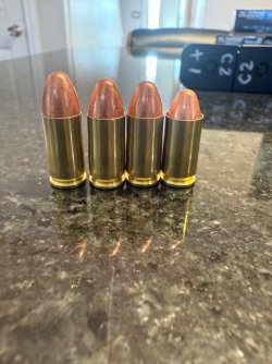

Got that. I see a Blazer headstamp on the damaged round. Factory fresh or reloaded? Just wondering about the primer and if it was sitting high.
Yep.. high primer is my first thought. Even if it was new factory blazer and not a reload, these three came out of the same fresh box from Blazer just a couple of weeks ago. No guarantees they couldn't mess up the other side of the round.. I was literally at my kitchen bar loading up magazines for the next day's range trip…when something didn't feel right…
