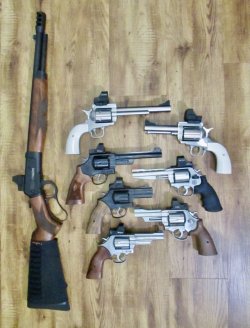

Now that I'm not a kid any more, I find eliminating the third focal plane makes life a bit easier. I'm surprised I dont have more of these.
That's a very nice rig, thanks for posting(y)
