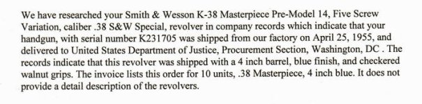

To throw a curve into this thread, I have a Pre Mod 14, 4", SN K232XXX that letter as having shipped to the the U.S. Dept of Justice in 1955 in a Shipment of 10! Anyone have any idea of where these would have ended up....

Welcome to the forum . . . and thanks for posting what may be the earliest example of a special-order 4" (heavy) Combat Masterpiece. Very interesting . . . hopefully others will be able to respond with more information about where they might have ended up.
In addition to the 10 in the 1955 shipment, was there any indication in the factory letter that there were other shipments in the DOJ order?
Based on the serial number and ship date I expect yours is a 5-screw example (four side plate plus one at the front of the trigger guard). We would all enjoy seeing pictures if you're able to post them.

It is a 5 screw. I'll try to get some pictures posted. No mention of add'l shipments in the letter.
Pre Mod 14, 4" shipped 1955 to U.S. Dept of Justice
It could have been a Border Patrol gun as mentioned in my previous post above. INS was in DOJ, and the BP was a branch of INS.
I have a copy of a Service-wide firearms inventory from about 1974, though, and while it mentions numerous K frames (and a LOT of other things) to include Model 15s and 6" K-38s, there is no mention of any 4" K-38s. But inventories were riddled with errors then and now; plus it wouldn't take much for these guns to be lumped in with Model 15s for inventory purposes.
Anyway, that was the only one I ever saw.
