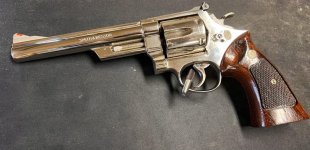

I do think I'll spring for some new stocks, but that's for another day. Here are a few pics of my 1st Model 29. Thanks all for the help!

Beautiful shiny nickel 29-2 ColumbusJBR. I like shiny nickel too. :D I have that same exact model 29-2 myself. I did replace the target stocks with some target Culina cokes, which feel really comfortable to shoot with. I'll post up a couple of pics of mine with Culina cokes installed for you to look at to help you decide whether to replace the targets yours came with.
First up, I put a set of football Culina targets in Cocobolo wood.
Then I decided to get a set of speedloader cut Culina stocks, which is what it wears nowadays. This wood is Jatoba I believe.
John Culina is a real artist with his offerings in my opinion. And he is also a member of these forums too and is active here. His stocks are not cheap, but then quality and pride of workmanship really shows through his work.
