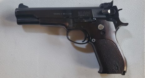

I have read where there is an internal lock-out device to prevent the pistol from actually being capable of a double action first shot. And indeed, nearly every picture that's ever been shared or captured of a no-dash 52 shows the trigger far back in the guard, ready for single action work but only for that.
Doesn't that look simply odd? Any long time admirers of the 52 want to admit they have never seen this strange oddity?
I saved that picture from a Gunbroker auction that ran nearly a decade ago! If you have never seen a 52 look quite like that… well, welcome to the party.
I've never seen one out in the world with the double action activated. And being that I have never owned a no-dash 52, I have also never seen the inner workings that show where this mysterious "lock out" device is located or how it works.
Now who amongst us -HAS- seen this? Who has a no-dash 52 and uses the double action setting?

My 52 is at home and I don't have pictures, but there is a screw in the frame above the trigger that simply blocks the trigger from swinging forward enough to engage the DA portions of the trigger. Just think of it as a pre travel screw with a whole lot of adjustment. I have never messed with mine, though I've been tempted just to see if the DA pull is as nice as I wish it was.
My M52 has the trigger set for SA shooting only and I have never tried to adjust it to a DA pull. As far as I can recall, all the 52's I have seen are set up this way. in the SCSW 5th edition on page 409 there are pictures of two model 52's with on showing the trigger set up for SA and the other set up or DA/SA.

I don't have a picture of the actual screw but it's shown in both pictures above, it's inside the trigger guard behind the trigger. in the picture I posted the trigger is almost touching it.

Not to question your pics Cougar015, but isn't the screw immediately behind the trigger a trigger overtravel adjustment screw? I thought I read the double action lockout screw was an internal screw that could only be adjusted with the slide off the frame. I could be wrong on this as I have never really taken a good look at this feature on a M52 dash nothing pistol.

Good question. I will have to check out a schematic which I should have done before I posted. So here it is and you are correct. The screw I mentioned is called the trigger stop screw and 6216 in the attached schematic. The double action Lockout Screw is 6215 in the schematic and can only adjusted with the slide removed. Thanks for pointing this out and I'm going to remove the slide on my M52 and check this out.
If that 6215 is the actual double action lock out screw… it seems to be in the same location (maybe the same part…?) as the pre-travel adjustment screw in the 52-1 and 52-2 pistols.
I have had four different 52's (a single dash-1 and three dash-2's) and I have never once adjusted the pre-travel screw.
Never having looked at a 52 no dash I am just guessing but I agree with Sevens. I think 6215 is one in the same for the lock out of the double action feature on no dash models. 6216 is only responsible for overtravel of the trigger. I have never needed to adjust 6215, only 6216 a very few times usually on well used pistols where the hammer wouldn't fall at times when the trigger was pulled. As I understand things there was a difference in the trigger shoes on early no dash 52's so this difference may be attributed to that 6215 screw and its adjustment. None the less it is an interesting feature.
