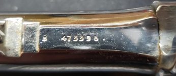

It's a 5" .38 Special Model of 1905, 4th change, with what appears to be a factory two-tone finish. The serial numbers on the bottom of the grip, on the barrel flat, and the cylinder face all match (473396). The serial number falls in the 1915-1942 range, according to SCSW 4th edition. It's close to the center of the range, so I would guess it was built in the late 20's. I think it'll definitely be worth it to get a factory letter on this gun, if for nothing else but to find out for sure if it is or isn't a factory two-tone.

Side plate seam would seem to indicate that it was polished pretty good at some point and then refinished. I wouldn't spend money on the letter.
It is a bit difficult to tell from your photos, but the finish may be hard chrome, which was done frequently. The B on the barrel flat suggests that it was originally a blued gun.
Apparently, there were some K frame M&P's that were chromed by the factory. They are quite rare, and if I remember correctly, the serial numbers were all in the 600,000's.

Definitely from the mid-1920s, very probably aftermarket plated. As you have already paid a handsome price for a .38 M&P (it is not a Model of 1905) in shooter-grade condition, I couldn't advise compounding the situation by ordering a $100 letter. It very likely won't tell you much beyond the exact shipping date and how it was finished when it shipped. But it is your money if you really, really need to know.
Your pics show numerous small pits that are plated over, so it was definitely plated sometime after leaving the Factory.
Gun was originally blue

Normally, that is definitive. However, IF this gun had been an original two-tone, the Factory MIGHT have pulled a blue gun from the vault and plated some parts to fill the order. We have seen other nickel guns that are marked with a B in that location that were apparently diverted from bluing or pulled from the vault and refinished in nickel to fill an order when they were not building the particular model that had been ordered.
I own a high condition 4 inch nickel 38 M&P that is obviously Factory nickel, but it is marked with a B in that location. It lettered as shipped in nickel. It has NO service marks.

Although MANY of these shipped very much in non-sequential order… without a factory letter but using my own database, I'm going to say the best guess is late spring to early summer 1924 on this serial number.
