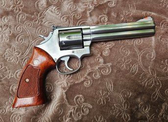

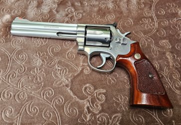

Picked up a 686-1. Found it at a Cabelas in West Virginia and had it shipped to Bass Pro in KC. Pretty slick. They didn't charge shipping and no FFL fee.
Pretty clean gun with box, papers, and unopened tools.

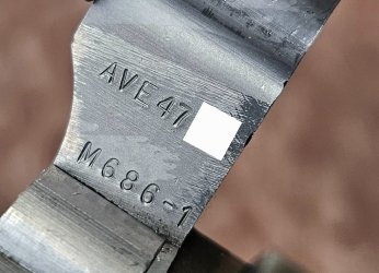

The model number on the gun shows M686-1. Not MOD686-1. And, there is no M stamped above the model number. I did some searching and cannot determine if it's had the recall work done or if they stamped M instead of MOD. Has anyone figured this out?
Special order code puts DOB at May 15, 1987. Coincidentally, I picked it up on May 15th.

Congrats. You picked up a fantastic revolver. Smith was at the top of its game with those beauties. Great action, strong, and extremely (sub 1.5" @ 25 yards) accurate.
I'm envious!
Thank you. It does seem tight and well made. I could have bought a new 686 for a little less money, but I wonder about current QC efforts.
Doesn't look like that gun has had the modification done. They put a single M by itself when it has been completed. Some guns may not need the fix, if the bushing is the correct size, and not allowing any primers to flow back into the bushing hole. S&W still does the recall free and sends you a shipping label for free shipping to and from.
I agree. After Garrett told me that his was stamped M686-1 plus he had the M recall stamp, it made me think that mine had not been sent for recall work.
The M stamp for the update is supposed to be stamped right above the model number. So, it does not have the update done, unless some who did it forgot to stamp it, which would be unusual. If it shoots fine with 125 grain All American ammo, it really does not need the update. But if you want it, Smith will still do it and pay shipping both ways.
Very nice gun. The L frames of that era are great guns!

NOT SO! The update covered the plain 686 AND 686-1 models. The 686-2 models came with the fix.

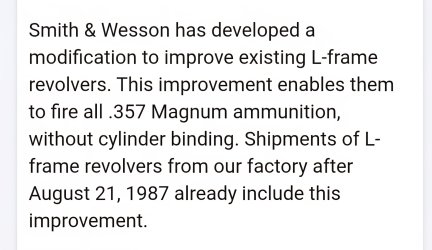

That was my understanding as well, so the response surprised me. Mine shipped in May of 1987. I found an old letter reportedly from S&W that said that L frames shipped after August 21, 1987 did not need the repair.

As a police armorer, the factory sent me the tools, instructions and parts to update all our department guns and others that needed to be updated from other departments. Presumably, L frames shipped after August 21, 1987 would be marked with a -2, or with an M for those already marked with the -1.

I agree with eveybody that says the M is added above the model number. The 'M' in the picture was original to the gun. The will still do the modifications if you want. And yes, you did well to pick up one of those. Mine is a no-dash and it has a GREAT trigger in both DA and SA.
