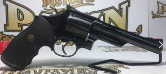

I am looking to buy a no dash 4 inch model 57. The gun is in excellent (99%+) condition without original box. Has factory Target Grips. Grips are cut for speedloader . I wonder if the grips are correct/original. What grips did 57's normally came with? Seller has it priced at 1200.00 , which sounds fair to me. Just curious about the grips.
It would depend on the serial number. The Model 57 with no dash number was made from 1964 until 1982. For the first three years the stocks would be targets with the football cut and the diamond at the screw location and probably (certainly?) made of GA.
In December, 1967, the diamond was ordered removed. So, sometime in 1968, the diamond disappeared, but the stocks would otherwise be the same for most of the rest of the run.
In about 1981, the N frame targets started having the speed loader cut. So it is possible the last year or two could have that configuration. But for most of the Model 57 run, the football relief would be correct.
Give us a partial SN and we can get close for you. Personally, as much as I like the M57, I'd buy that one for $1200 as long as the finish was good and it was mechanically sound. I'd like to have a 4" model to go with my "S" 6 incher (which I gave $1300 for without factory stocks, 2-1/2 years ago). You can always look for a set of period-correct stocks, but my guess is, the footballs are what came on yours, they were the prevailing type over the no-dash's run. (If that turns out to be an "S" prefix, you better do that deal quickly, before someone else does.)

The one I am looking at is an N PREFIX serial number , P&R later gun. The finish and mechanics are excellent. Finish is 99%+. I am just going to get it I think. I fill figure out the grips later. The target stocks it's wearing now look good anyway.
