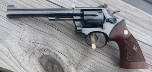

Have a 1956 vintage K22 wide rib shipped with a target hammer and target stocks, NR type. It letters to Sports Inc. in Chicago.Gun is about mint and came in a solid white line, blue box. Big Larry

Thanks all. My motivation for bringing this subject up again is I recently acquired a 4 screw NMM K-38 that has K NRT's installed. I will be submitting a letter request for this unusual 5" K-38 (~1956?). Yes, I was the high bidder, AKA The Greater Fool" on that one.

I'm hoping it shipped with the NRT's but I have my doubts. We shall see.
