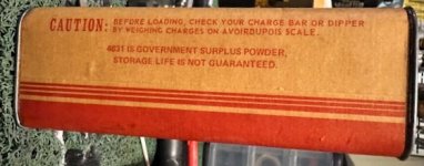

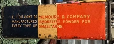

I recently picked up these old cans of powder. Anyone know approximately how old these are? Both are in good condition, no rust inside with about 75% full. Any value to them?

With no ZIP codes on the addresses, they could be early 1960's. With writing on the can it hurts the collector value. Collectors are usually looking for unopened stuff.
Those were sometime prior to 1965, the year I first bought IMR powders. Cans were the same but labeling was slightly different as I recall.

Most collectors that I know prefer unopened items. Empties in some cases will be used as place holders until they can find like new items. These folks have more funds than this old boy. I usually take anything that is old and in decent shape for my collections.

The two cans of 4320 in the middle look like the containers I bought when I first started reloading in the mid 70s. But I know I didn't pay $6.50 for a pound of powder back then. It was almost half of that.

My Father gave me these cans in a bunch of reloading equipment in 1974. They were at least 20+years old then. He stopped reloading in the mid 1950's. I tried some of the powder in 1975 (have the loading data in my records). He had also given me about 10,000 primers in plain cardboard boxes and with cardboard and wooden trays holding the primers. He said they were Army surplus.

Is powder that old any good?
It can be, I have used some very old powder at times. Not hard to determine if a can has gone bad, usually develops a nasty smell and tries to consume the can from the inside, resulting in the powder being full of rust particles. You can see a similar issue with old lots of ammo sometimes that go bad. I have only had a couple cans go bad in all the years I've been reloading (started back in the mid 70's) and one of those was only a few years old.
I suspect the quality and stability of the original production as well storage conditions have a lot to do with the life span of the powder. Many seem to last a very long time with no problems while occasionally a batch just seems to go bad suddenly.
