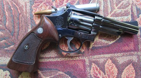

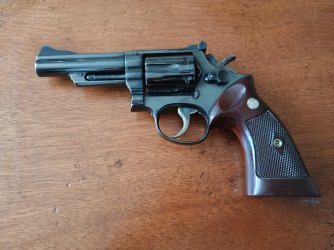

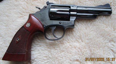

Here is my early production Combat Magnum K261590 shipped August 16, 1956. My letter says walnut target stocks.
One other question please. There seems to be an overlap in the production of the non-relieved targets (NRT, 1951/52-1958) and the relieved type (1956 and beyond). Which would have been installed in the first half of 1956 on the CM? I doubt a letter would distinguish between the two.

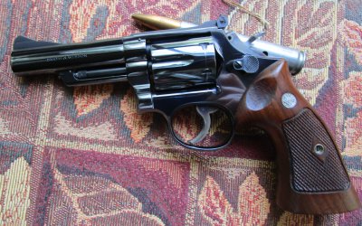

Just checked and have your Serial K 316720 in my notes but no ship date, closest one to yours is
Serial K 317946 Shipped May, 1958 and has no model marking.
Imo the stocks on your K316720 posted are actually from the mid 60's due to their rounded heel radius.
