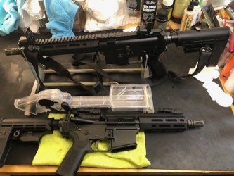

I started my AR-22 journey with a conversion kit in an existing 223 upper. Within a year I built a dedicated upper with a 16" M4 style barrel. I just recently rebuilt it with a pistol length barrel for my SBR since I just got a 22lr suppressor. I'm probably going to change to a quiet collar from BoreBuddy soon.
Here's mine below as she currently sits. Just has a cheap red dot on it at the moment, I haven't decided if I'm going to switch to iron sights for this one or go with a lower powered scope. Excluding optic, I have about $300 in the upper as is.

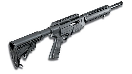

An interesting rifle, is the Ruger SR22.

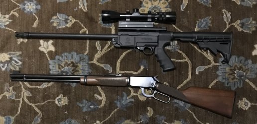

Pic from the web, and will post ours, along with the Win 9422, when I turn on the computer.
A Smith at Ruger, apologized, for ever making that contraption. 😱
So, is a minty 9422, in your plan?
