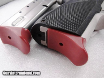

Red 6904
Did it come with a factory box? If it has model 6904 on the frame then that's what it is but that is a 6906 slide.
FYI - I tried to contact seller regarding 2nd listing of a RED 6904 - that listing is now pulled down. It appears the listing was a duplicate - I have seen that happen especially if seller tries to modify listing after initially posting it - photos of 2 listed "pistols" are identical down to wear marks on slide and shadows in background - so probably a SINGLETON RED 6904 with a 6906 slide and aftermarket grips.
2 options short of an expensive letter:
If you email SW at [email protected] and include model and full S/N you can request Manufacture Date and 6 digit Product Code - you may or may not get 6 digit Product Code along with Manufacture Date in initial response but if you respond to email and ask nice they will generally give you that too.
Based on the D shaped trigger guard, the standard Product code could be 103106 with original fixed sights (1988-mid 1990) or 103108 with Novak fixed sights (mid 1990). The Curved trigger guard with Novak sights (108130) came in some time after May 1990 and before Feb 1993.
If the pistol had any unique factory provenance it would most likely have a unique 6 digit product code. Police procurements after about 1995 typically had unique codes but that probably would not help on a 1990 (+/-) vintage pistol.
The second option - if you have access to the Member Only services below - is to use the "Ask Roy" link again including model, serial, and maybe a photo. Also include the number on right side and you might Police or other unique pedigree.
^^absolutely fantastic advice.
Yes, a factory letter would be "better" but that's really a lot of cash for what seems to be a less-than-dirt chance that S&W would have made a red framed pistol.
Thanks all.. Best reply was a 6906 slide on a colored 6904 frame.. The Factory said the S/N TET10XX was a 6904 made in 1989. I am still happy to add this oddity to my collection. I also saw that the 2nd GB listing had been removed, so there goes my plan to buy that one too!. This seems to be the results from a labor of love created by someone who had more money than sense! ..... I got it for the opening bid of $465, if anyone wonders.
Photos of "2nd" pistol were identical to the listing for the one you bought - and as you noted 2nd pistol withdrawn - I suspect it was an inadvertent duplicate listing and there was only 1 RED 6904.
