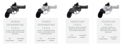

As most of you probably know, Taurus is manufacturing their TORO line of revolvers that are all optics ready, and apparently they are quite popular. I wouldn't be surprised to see S&W come out with their own line of optics ready revolvers in the very near future.
