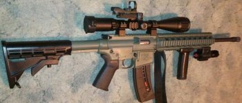

Just mounted mine up. Lovin this setup so far. Can't wait to put some rounds down range. UTG 1" Dual Picatinny Rail Scope Adapter.
