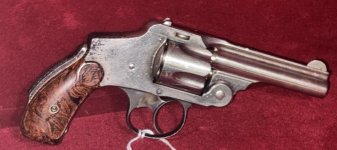

Anyone ever seen a pair of red mottled stocks a 38 Safety Hammerless 1st model? I bought this on everyone’s favorite auction site a couple weeks ago and it just arrived yesterday. It’s a nickel 3 1/4 barrel model serial 2805 out of 5250.
The stocks seem to have been on the gun a long time and have the serial number in pencil.. One of the panels has a hairline crack, but it’s small and seems stable so it doesn’t bother me.
I’m a terrible photographer but the stocks have a beautiful color. This is my first pair of the red mottled stocks and I’ll probably send for a letter on it this week. I’m not sure the letter will say if they were red but it’s worth a shot.
There isnt a lot of information on these stocks that I’ve found online, I’ve read that there may have been other colors made by S&W. Can anyone post a picture of a S&W wearing a pair of stocks in the other colors?

Love these mottled grips. I don't have the experience the older members have here, but I have studied them and kept records of guns that wear them for the last 4 years.
Hard rubber grips are very stable over time and they shrink very little. Each pair of grips were fitted at the factory and adjusted to fit perfect to each gun. Looking at the grips for your gun, they don't have the perfect factory fit. The grips look a little smaller than the frame in several places.
The serial number under the right grip looks like it was added much later than the factory would have written it. The grip numbers script should look a lot more like the serial number on the bottom of the frame.
The books say that mottled grips were fitted only to blued guns, but that is not entirely correct. Most blued 38 SA 2nd models wear mottled grips after about serial number 30,000. Many nickel 38 SA guns wear them too from the middle of the production run. The 32 SA has a similar story.
38 DA and 32 DA guns wear mottled grips too. Most of the DA guns with mottled grips are blued. Occasionally a nickel gun shows up with them.
The 44 DA revolver wears them. Every single one I have seen has been blue with low 4 digit serial numbers.
I have not seen a safety hammerless in 32 or 38 that look like they were installed at the factory. That does not mean they don't exist, if they do they are very rare.

I was hoping you’d see this thread and comment on the stocks. The serial number was a concern for me, but I only had late teens/early twenties stocks with the number in pencil to compare it to. I’ll order a letter today and see if they have the color listed. There’s a 2nd model Safety Hammerless in the Standard Catalogue 3rd edition but I don’t know if they were factory installed.
Can you post any pictures of factory mottled grips in any other color than red? I’ve never seen a pair posted online before. I’m going to post a couple more pictures I took yesterday, I’ve not had a chance to get it outside and take anything in good lighting.

I have never seen the other colors on the mottled stocks. Others here have. I think I have read here that they were installed on the Double Action guns. The other colors were probably prototypes, and since Smith and Wesson never threw anything away, they installed them on a few guns and sent them out the door.
There are 3 styles of the red mottled grips, not counting the S&W logo variances on the grips. One is the swirled pattern like your revolver. Another is the straight pattern like the 38 Safety Hammerless you mentioned in the Standard Catalog of Smith and Wesson. The last is a very dark straight pattern. The very dark straight pattern is least common and is found on both the 32 SA and the 38 SA.
