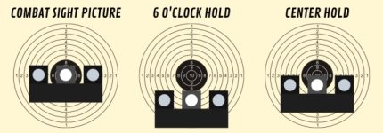

First, I tried the 6 o'clock and missed the paper on 9 of 10 rounds on a 12" target at 7 yards. The combat sight picture got me on the paper but still quite low. If I aim 5" above the center of the bull, it shoots great.
Start with slow fire and don't yank the trigger. I was once told to "let the gun fire itself", meaning to go easy on the trigger. Become accurate first, and work on speed later. I have three M&P pistols, a 40c 357 SIG conversion, a Shield 45, and a 1.0 Shield 9 with nearly 30,000 rounds between them. They all shoot best with the combat hold sight picture. As to 9mm ammo, after trying many types, I've found that Winchester NATO 124g rounds are easily the most accurate ones I shoot from my Shield 9.

Being that low at that range, it ain't the sights or your sight picture. It's your trigger manipulation.
The "combat sight picture" has been mentioned here, as it has many other times. That refers to where the dots on the sights line up so far as vertical shot placement is concerned.
Frankly, I've got severe doubts any gun is set up that way. The dots got started as a quick and dirty sight reference to improve visibility of black sights in some conditions. Recycling a phrase: it's combat accurate/acceptable for those conditions. Most guns are coming out of the factory are sighted in the conventional manner, with the ammunition most commonly used in that caliber. Note that last phrase.
However, where the bullet lands vertically is affected by: your trigger press, the strength of your grip and the ammunition. I've got a 5906 that's been to many schools and it shoots pretty much to the sights as they came from the factory with 115 gr & 124 gr 9 mm ammo of either standard or +P versions. However, when it was the new guy on the block, I was gifted with a couple of boxes of Federal Hydra Shok 147 gr. ammo. Interesting stuff, probably the most accurate 9 mm ammo I've ever shot. From sitting I could put 5 rounds in one ragged hole at 25 yards (Oh to have those eyes back!). However, the hole was right smack where the white dot on the front sight was. I'm not sure if that was my hold or just where the bullets flight took it.
Made it a great choice for use at night where the front tritium insert might be my front sight.
<snip>
Sig's FAQ states:
All SIG SAUER production duty/combat pistols are set up to use a “combat” sight picture. This is where the front sight completely covers the bullseye of the target. Using a six o’clock (“pumpkin on a post”) or center mass (“half’n’half”) sight picture will result in low impact. SIG SAUER, Inc sights in all non-sporting and non-target pistols for 2 inch groupings @ 10 yards. <snip>"
