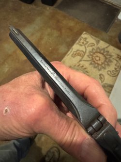

The stamp on the top of the barrel;
SMITH & WESSON SPRINGFIELD MASS.

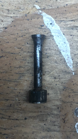

You mentioned Tig welding? If you tig weld this repair is easy. I mig weld and more often I just weld a new head onto the original screw. See photos. Very productive and fun repair vs trying to fit new screws can be a pain.

Attached is the photo of the barrel.

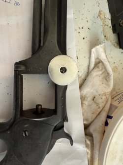

Tip Up Pivot screw
A friend of mine owned a specialty fab shop servicing the medical industry. They made fixtures to very tight tolerances. This friend can do any thing with metal! He is the one that has the tig welder and has done precise work. He gave an example of a production run, welding a bead around a 3/32" pin to secure it. Because the screw slot is mostly gone, the idea to tig weld a washer or square pc on the screw head as seen in the photo. Clear to heat the tip up hinge.

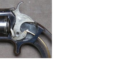

Trigger screw pivot/side cover, see photo from on line. Where to apply heat? opposite of the cover? I saw a cool screw extraction trick on line. After penetrating oil/heat/tap, place the correct size screw tip driver in a drill press. Using the drill press lever arms, put a downward force on the screw head. With vice grips on the chuck or steel rod where chuck key goes, rock forward and backwards to break the threads free. I also thought I could use an engraver to vibrate the screw slot. Like a 1000 tiny taps?

That’s great! The main spring is strong so no real heat damage. I like the idea of welding a washer to the head of the screw. That will give you the torque to extract it. It’s always better to save and repair an original screw if possible. So much easier.
Be very careful not to get weld on the surrounding metal. That’s not going to be easy.
I would first try to center drill the head and use a very small easy out with a little heat applied/oil. Once you remove the screw simply weld a new head on the screw.
