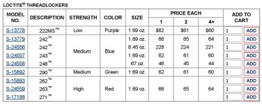

Choose wisely...blue Locktite is YOUR friend, red Locktite is the friend of the assembly!

Used in large amounts on properly prepped material, blue loc-tite can be really, really close to red.
BTW, color isn't necessarily a true indicator of properties. The loc-tite product number is.
