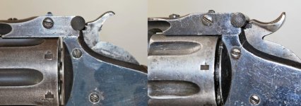

comparison pictures of the 1st and 2nd model hammers
