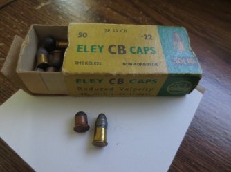

Way back in the '60's I remember (Flobert?) BB caps and pointed .22 short size conical caps, with copper cases that came in a cardboard tube, like a "tire tube repair kit" came in. Then again we're talking over half century ago so memory fails. Joe
Here are a couple types of CB Caps.
