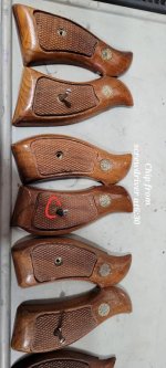

I have come across some S&W stocks that appear to be from the late 1940's-1950's that I am not certain if that is correct.
I have looked through all three Catalog of S&W books that I have and that is the approximate age that I can find at least.
Just looking for some verification and approximate values if possible.
I plan on posting a for sale ad in the Classified Section of the Forum once I get the facts as close as possible.

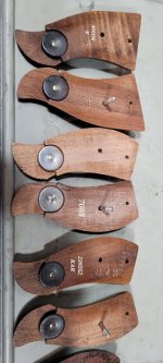

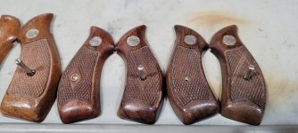

I have photographed both front and back of each and notated the stamped-in serial numbers and alphabetic ID if included. Only a single set/pair has the diamond shape around the screw bezel. One also has been slightly damaged at some point in its life by the user using a screwdriver with a blade that was too wide and made a chip in the checkering next to that bezel (Circled in red).
Any help would be appreciated.
Thanks so much to the experts on this Forum!
mike
The top set is for a fixed sight SB K frame, 1967-'73 (no diamond, blued stock circle).
The second, for a fixed sight or short barrel adjustable sight RB K frame, 1973 to early '80s.
The third, most interesting, for a fixed sight RB alloy K frame (model 12, called the KA frame by the factory), same time frame as the first set.
The first set of (diamond) RB J frame stocks is from about 1962, and the other set from about 1966.
