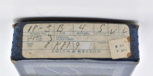

I have several S&W Model 18's that have original target triggers and hammers but no target stocks. The boxes reflect the target options except for the stocks. In that box is an S, designating square butt magna's

Here's one of my Model 18's with the target trigger and target hammer and no target stocks. The original box reflects the options. As far as the reasoning goes, you got me.
