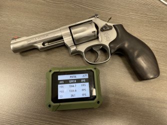

Magnum load with 15.5 grains of H110 and a 160Gr cast Keith HP. Seated deep and crimped above the front driving band
Chase45, I would think your load would be about maximum, and handle anything that could be handled by a ..357. Seems similar to the hottest factory load I've encountered. That factory load that is warmer than any other factory or handloaded .357 load I've used; the Buffalo Bore .357 180 WFNGC. They advertise it as doing 1400 FPS in a 4" revolver. It actually does that in my 4" and 5" revolvers, and just over 1500 FPS in a 5.5" gun.
