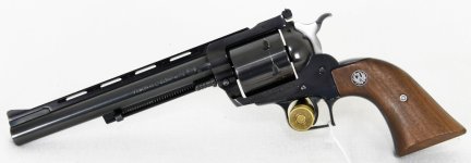

Does anyone remember the advertisements in the gun magazines by the Polychoke company for ventilated ribs that were made for Ruger Blackhawks ? I guess they were epoxied on. I found this photo on the internet. Not something I would ever have done but for those who thought it was a good idea ........
