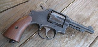

Just acquired V 121 432. Numbers matching in all places. Extrapolating from info in this thread, I place it in 1942; correct? It has the ordnance bomb stamp, but no top strap markings, so I'm looking forward to the letter.
It also has an S on the cylinder face, but no place else. Would that be related to the improved hammer block or not?
