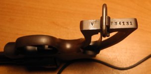

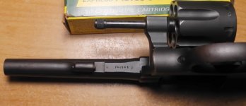

I have just filled out the S&W Letter of Authenticity Request Form but thought I'd post some info here on my S&W. I received it from my father-in-law who was a WW II veteran and a Corregidor POW. After the war he returned to AD and during an assignment to Spain (Torrejon AB) he acquired this .38 from military surplus sales. Here is the serial # and some images:
Serial V 734131 P
Any details or insight would be appreciated.

I just saw yesterday's post and my Victory does not fit a .38 Special cartridge. I was told by a gun shop that the correct cartridge was a .38 Colt Short.
