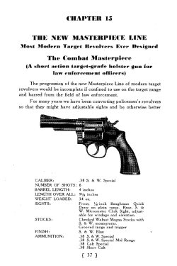

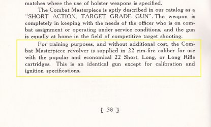

While records state that the 22 Combat Masterpiece was formally introduced in 1949, I have no shipping records for this model until 1951. A member here has an experimental serial numbered 4" 22 Combat masterpiece built in November 1946.
The Centennial Catalog of 1952 was the first I have found that describe the 22 CM, but only mention it as a target gun for law enforcement, not the general public. There was a brief mention of the 22 CM in circulars of that era as well. For some reason they did not publish the introduction of this 22 model to the masses. Apparently, the company was still concentrating on the law enforcement market. Pages from the 1952 catalog for the Combat Masterpiece in 38 caliber listing and the 22 CM paragraph.

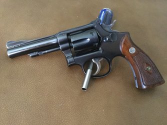

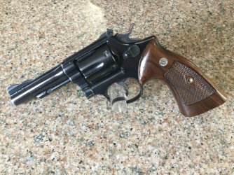

Thank you. Is $625 in range then? Not including transfer, shipping, etc.
Cheap aftermarket grips, no box.

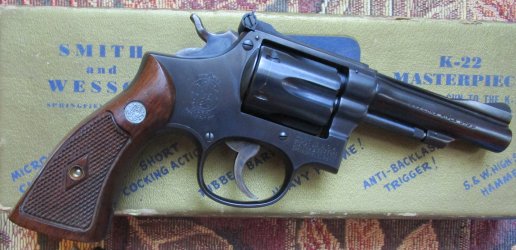

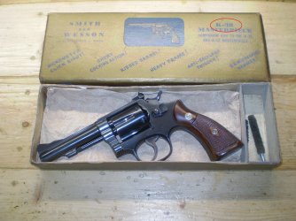

Condition is every thing. The after market grips would blow it for me, as it would have come from S&W with magnas with the serial number stamped on the inside of the right grip panel. Still, a 5 screw 22 Combat Masterpiece is a very desirable in my book. Here is one that came in a Masterpiece box.IMG_1199 (2).JPG

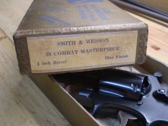

The confusion about "K"22 and "K"38 Combat Masterpiece revolvers might be partially explained by the boxes used to ship them out. The gold boxes for the 22 and 38 Combat Masterpiece revolvers used the 6" box with a glued on label on the end of the box. The label did not contain the K, but of course the lid did.P1010001.jpgP1010008.JPG
Well crap. On close inspection after I got it home I noticed that the finish on the barrel is slightly more glossy than the frame. I also found a history note in the case that it was sent back to Smith and Wesson where a new barrel was installed.
That and the target hammer leads me to believe that it originally left the factory as a Target Masterpiece.
Oh well, it should serve well as a shooter.
