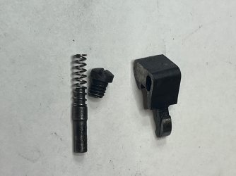

B -BTM- Member Joined Jan 14, 2025 Messages 218 Reaction score 281 Location Yuba county Jul 24, 2025 #1 It’s a 5-digit serial number .32-20. What are the odds a more modern version will fit?
dwh Member Silver Supporter Joined Dec 14, 2014 Messages 597 Reaction score 1,968 Location SW PA Jul 24, 2025 #2 You can probably find the correct one on eBay or Numrichs site. It’s the same as the later prewar 38spl’s.

M Muley Gil US Veteran Bronze Supporter Joined Feb 8, 2005 Messages 18,499 Reaction score 27,578 Location The SW Va Blue Ridge Jul 24, 2025 #3 Slim to none. You probably need a cylinder stop for a revolver that uses the screw and spring that is in front of the trigger guard. Please post a picture of your revolver with the side plate removed.

Shotguncoach Member Gold Supporter Joined Jul 25, 2017 Messages 1,180 Reaction score 7,044 Location Arizona Jul 24, 2025 #4 Ask and ye shall receive…but you have to send me your address again.
M M5741 Member Bronze Supporter Joined Feb 19, 2025 Messages 74 Reaction score 72 Location Willamette Valley, Oregon Friday at 11:22 AM #5 I had to replace mine in my 1921 model 32-20 HE. Original had to much wear. The one in the picture that Shotguncoach sent looks just like the one in mine. Good shooting.

OP B -BTM- Member Joined Jan 14, 2025 Messages 218 Reaction score 281 Location Yuba county Friday at 11:59 AM #6 Shotguncoach said: Ask and ye shall receive…but you have to send me your address again. View attachment 779034 Click to expand... You are the man. It’s in jail, I’ll let you know when it is in hand.
