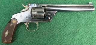

I purchased a New Model 3 from the US that was described as being chambered in 44 S&W Russian.

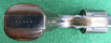

Upon inspection, the revolver is in excellent condition with matching numbers on barrel, frame, latch, cylinder, and extractor. The checkered walnut grips fit the frame, but are not numbered. The cylinder shows the step found on my other New Model 3’s that are chambered in 44 Russian and the rifling in the barrel is consistent with that found on my other NM 3’s. There are British proofmarks on the barrel, frame, and the cylinder flutes.
I put the gun aside for a month or so without ever placing 44 Russian cartridges in the cylinder. When I did, I was surprised to discover that cases would not extract without some ending up under the extractor. I am embarrassed to say, it took me much longer than it should have, to realize my new pistol was .45 calibre and not .44.
With the British proofs, I suspected the gun was chambered in one of the .45 calibre British cartridges such as 455 Webley, but it appears that it might be chambered in 45 Schofield instead.
Taking some measurements, I found .479” chamber diameter at the back end of the chamber, .455” at the front of the chamber, and 1.04” from the back of the chamber to the step in the chamber. This caused me to suspect it might be chambered for .45 S&W. Unfortunately, I don’t have a Schofield round or case to test my theory.
I do have some .455 Webley cartridges which chamber and extract OK, but the cartridge rims leave a noticeable gap from the back of the rim to the recoil shield. The Webley rims are thin compared to the cartridge rims on the 44 Russian rounds. The 44 Russian rounds have the correct rim thickness for use in my revolver, and I note that the .44 Russian and .45 Schofield have the same rim thickness.
Is my revolver possibly chambered for .45 Schofield and if so, would 455 Webley rounds safe to shoot in it?

Could the cylinder be chambered in 44-40 (44WCF)? The larger diameter of the rim would allow the extractor star to slip over the rim of 44 Russian yet still have a 44 caliber barrel. Just an idea.
Ivan
These were not chambered in 44 WCF. I would run the serial number past Roy Jinks and see if he can identify the caliber. I agree with Mr CVS that you will likely need a letter though. Could be rare.
Perhaps some closeups of the markings may give us a clue?
Check the face of the cylinder for a measurement of the chambers. plus give us measurements of the lands and grooves from the muzzle. There were a few slightly different British calibers made with this revolver. The 450 Revolver, 455 Webley, 455 Mark I and Mark II was known to have been produced by S&W. Barne book on cartridges of the World shows exact dimensions of these rounds.
Not sure I would rule out 45 Schofield until you check the case you were using. Some modern and converted 45 Colt cases have a very small base. Schofield had a .522" rim while Colt had only a .512" rim. The Scofield has a 1.1" case length and a .476" base diameter. 450 should measure .477" base and .89" case length, while 455 Webley is .480" case diameter and only a .77" case length.
Of course the New Model 3 was made in 44-40 with some 2072 Frontier 44 Winchesters manufactured, but the base diameter was smaller, .471", but would have two restrictions in the chambers, one for the step in the case and one for the step down for the .429" bullet.
FWIW; I've had several NM#s in .45 Schofield over the yrs and the letters came back as "caliber 45' Jinks told me that most of the shipping records for .45 caliber NM#3s in .45 just say ".45" None of shipping records for guns in .45 Schofield mention the name Schofield . However NM#3s I've had in .450 Eley or .450 Webley lettered in those calibers. Ed

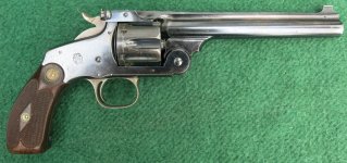

Thanks for the replies.
When I sent for the letter, I thought My revolver was a chambered in .44 Russian as I had taken no chamber measurements yet, or even put .44 Russian cartridges in the chamber.
In my letter request, I stated the revolver was in . 44 Russian, not .45 calibre which is what I actually have, so the research would have been for a .44.
My letter request was received just before they stopped accepting requests altogether.
From the letter I received, I am not sure if all 5 units in the shipment were for .44 cal, checkered walnut grips, 6 1/2”barrel, etc; or if there were other calibres and configurations in the shipment.
The rifling in the barrel of my revolver is consistent with the rifling in the .44 Russian NM3's I have, just .45 cal. Five grooves, right hand twist, the lands and grooves look to be equal width.
My revolver shows no signs of being reworked, with evidence of blue in both ends of the chambers and barrel. No factory rework marks on frame.
With the measurements I've taken, I am leaning towards .45 S&W.
