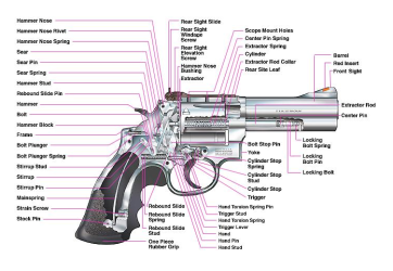

Included in a small sealed baggie with a new-to-me S&W 28-2 was the small part and spring shown. What is this?
Frankly, I'd dismissed it (but didn't discard it) until the gun skipped a chamber maybe 6-7 times during the 140-plus-round initial range visit recently. I'm suspecting a weak cylinder stop spring, but that is only based on a quick Google search on the "skipping chamber" topic. I realize there may well be zero connection between this item and the skipping.

Thank you both and there is a visible part as shown; the cylinder notches are being engaged by this.

The part is the cylinder stop and, probably, it's spring. Since your photo shows there is a cylinder stop in the gun it was probably replaced and the old one was in the bag. Unless you want there is no reason to remove the sideplate to see if everything is correct inside.
Cylinder stop is not engaging the notch properly. For one, you can see a burred edge on the stop in your photo. It would be interesting if it skips on the same chambers. Take a close look at the notches in the cylinder. If I had the gun, I would start by removing the stop, remove the burrs and check to see how the stop fits into each notch. There may be burrs there as well.
My powers of deduction say you have an "new" oversized stop in there that wasn't fitted 100%.

You need to locate which chambers are being "skipped" and insure the cylinder stop will fit those notches by width and depth. As others have said it appears to be a new stop and may be to wide for those particular chambers and needs dressed. It looks to have plenty of protrusion above the frame window surface but if not enough for those chambers you will need to file the flat on the stop just behind the hump. While your at it looks like the edge needs to be broken on the left hand side of the stop to match cylinder direction of rotation into the bottom of the "T". These are all very minute adjustments so go slowly with changes. Also check the notches on those chambers for damage.
The part is the cylinder stop. Was the gun reassembled without it? Is there anything engaging the cylinder notches? If it was omitted, that could be your problem. It does take a bit of finesse to get back in place.
