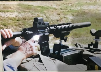

Take this with a grain of salt...
I'm happy with the results. And I didn't need salt, only a Banish Backcountry Suppressor, Witt Machine clamp on adaptor, Hornady sub sonics, and a Diamond D chest holster to carry it with. I never followed up with the thread I started...one of those why bother things, nobody here would believe it anyway, or those that might would tell me I'm nuts and don't need it.
